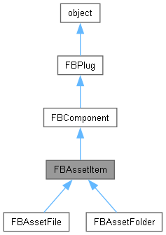

Base class for all managed assets. More...
#include <pyfbsdk.h>
