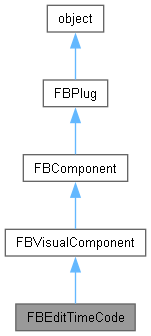

FBEditTimeCode Class Reference
#include <pyfbsdk.h>
Inheritance diagram for FBEditTimeCode:
Public Member Functions
 FBEditTimeCode ()
 Constructor.
