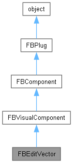

Vector edit widget. More...
#include <pyfbsdk.h>
Public Member Functions | |
FBEditVector () | |
Constructor. | |
FBVisualComponent () | |
Constructor. | |

Vector edit widget.
FBEditVector | ( | ) |
Constructor.
FBEvent OnChange |
Event: Vector value changed.
FBVector3d Value |
Read Write Property: Current value of vector.
