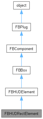

Inheritance diagram for FBHUDRectElement:
