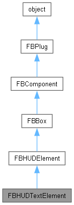

Inheritance diagram for FBHUDTextElement:
