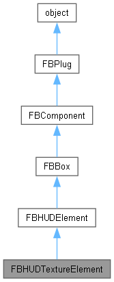

Heads Up display. More...

Heads Up display.
Texture HUD element. Display a texture on a rectangle on the HUD.
FBHUDTextureElement | ( | str | pName | ) |
Constructor.
pName | Name of new HUD texture element. |
FBListTexture Texture |
Read Write Property: Texture to display.
