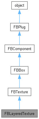

Inheritance diagram for FBLayeredTexture:
