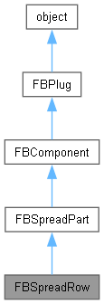

Spreadsheet row. More...
#include <pyfbsdk.h>
