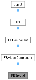

Base spreadsheet class. More...
#include <pyfbsdk.h>

Public Member Functions inherited from FBVisualComponent | |

Public Member Functions inherited from FBComponent | |
