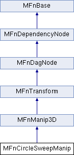

+ Inheritance diagram for MFnCircleSweepManip:
