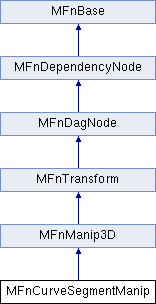

+ Inheritance diagram for MFnCurveSegmentManip:
