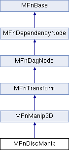

C++ API Reference
DiscManip function set. More...
#include <MFnDiscManip.h>
+ Inheritance diagram for MFnDiscManip:
