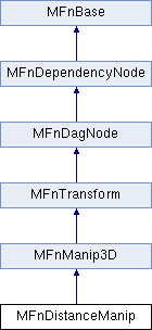

+ Inheritance diagram for MFnDistanceManip:
