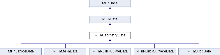

+ Inheritance diagram for MFnGeometryData:

Reimplemented in MFnNurbsSurfaceData, MFnNurbsCurveData, MFnSubdData, MFnMeshData, and MFnLatticeData.
