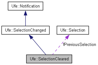

Inheritance diagram for Ufe::SelectionCleared:
Collaboration diagram for Ufe::SelectionCleared:
