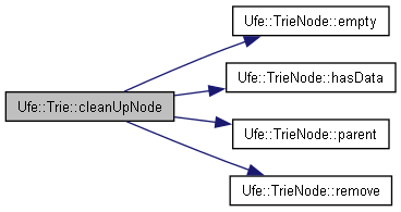

◆ cleanUpNode()
template<typename T >
void Ufe::Trie< T >::cleanUpNode ( const typename TrieNode< T >::Ptr &  node)
private
Definition at line 421 of file trie.imp.h.
References Ufe::TrieNode< T >::empty(), Ufe::TrieNode< T >::hasData(), Ufe::TrieNode< T >::parent(), and Ufe::TrieNode< T >::remove().
Here is the call graph for this function:

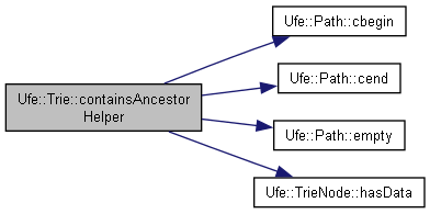

◆ containsAncestorHelper()
template<bool INCLUDE_DESCENDANT>
bool Ufe::Trie< T >::containsAncestorHelper ( const Path path) const
private
Definition at line 343 of file trie.imp.h.
References Ufe::Path::cbegin(), Ufe::Path::cend(), Ufe::Path::empty(), and Ufe::TrieNode< T >::hasData().

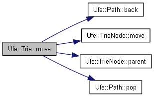

◆ move()
TrieNode< T >::Ptr Ufe::Trie< T >::move ( const Path oldPath,
const Path newPath
Definition at line 433 of file trie.imp.h.
References Ufe::Path::back(), Ufe::TrieNode< T >::move(), Ufe::TrieNode< T >::parent(), Ufe::Path::pop(), and UFE_ASSERT_MSG.
