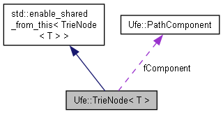

Inheritance diagram for Ufe::TrieNode< T >:
Collaboration diagram for Ufe::TrieNode< T >:

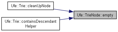

◆ empty()
template<typename T >
bool Ufe::TrieNode< T >::empty
Definition at line 143 of file trie.imp.h.
Referenced by Ufe::Trie< T >::cleanUpNode(), and Ufe::Trie< T >::containsDescendantHelper().
Here is the caller graph for this function:

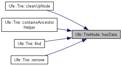

◆ hasData()
bool Ufe::TrieNode< T >::hasData
Definition at line 200 of file trie.imp.h.
Referenced by Ufe::Trie< T >::cleanUpNode(), Ufe::Trie< T >::containsAncestorHelper(), Ufe::Trie< T >::find(), and Ufe::Trie< T >::remove().
