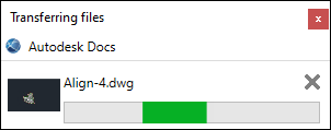

    • After you release your cursor, a message box will be displayed while the documents and folders are being copied.
