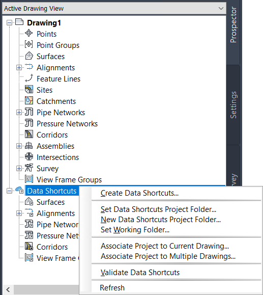

  1. In Toolspace, on the Prospector tab, right-click on the Data Shortcuts node Set Working Folder.
  2. In the Set Working Folder dialog box, navigate to the project folder location in Forma Data Management.
    The working folder for data shortcut projects needs to be at least one folder level below the Forma Data Management project folder. For example, <Forma Data Management Drive>\<Account Name>\<Project Name>\<Working Folder Name>. It is not permitted to set the working folder to a folder outside the project.
    Note: It is possible to set the top level \Project Files folder as the working folder, but only administrators can see the \Project Files folder so it is recommended that you use a subfolder within \Project Files.
  3. Click Select Folder.
    The Data Shortcuts node in Prospector changes to to indicate that the working folder is in Forma Data Management.
  4. Right-click on the Data Shortcuts node New Data Shortcuts Project Folder.

  6. Right-click on the Data Shortcuts node Set Data Shortcuts Project Folder.
  7. Select the data shortcut project to use and click on OK.
