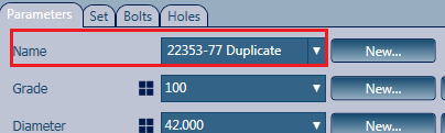

To duplicate a bolt:

Clicking on one of the nut or washer types brings up their properties page on the right side of the application window. Here you can modify the parameters of existing types, duplicate an existing type or create new types by clicking the New button next to the Type drop-down list.
You need to choose valid parameters in order to be able to create the new type and save your settings. After entering all the required parameters, click Apply to save your new nut or washer type.
If you need to create a completely new bolt, with blank properties fields that you can define as required:
