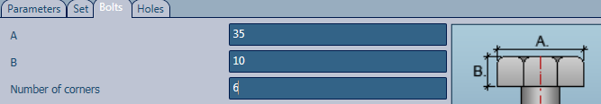

In the Bolts tab:
See Create and Customize Nut and Washer Types. The following configuration was made, to suit the bolt that is defined in this example:

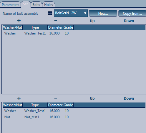

After defining your new nut and washer types:
For this example, one washer was added for the top part of the bolt and one washer and one nut were added for the bottom part of the bolt:

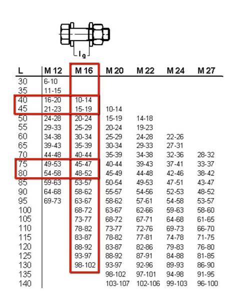

Rules are defined following certain norms. So for this specific example, the norm for a bolt body 16mm thick (M16) has the following pattern, where L is the entire bolt body length and lg is the bolt grip length (between the washers and nuts):

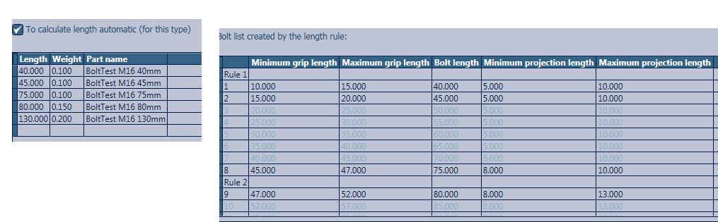

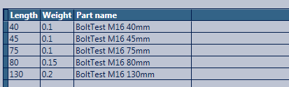

In the Bolts tab table, the defined bolt lengths were 40mm, 45mm, 75mm, 80mm and 130mm. Therefore, the rules will be defined for those specific bolt lengths.
To create a rule in the Management Tools table, you need to find a pattern in the norm.
According the norm used in this example, the bolt lengths increase by 5mm and so do the grip lengths, until the bolt length reaches 75mm. Therefore, the minimum grip length for the bolt lengths between 40mm and 75mm will be 10mm, with a step for the bolt length increase of 5mm and a maximum grip length of 47mm.
When the bolt length reaches 75mm, the grip length increase is no longer 5mm, but shorter. This means that the pattern changes and you need to define a different rule for the bolt lengths starting with 80mm.

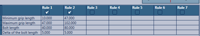

The two rules that result from this norm patterns will be:
Rule 1: for bolt lengths between 40mm and 75mm, the minimum grip length is 10mm, the bolt length increase (delta) is 5mm and the maximum grip length is 47mm.
Rule 2: for bolt lengths starting with 80mm, the minimum grip length is 47mm, the bolt length increase (delta) is still 5mm and the maximum grip length is 102mm.
After entering the rules in the Parameters tab, click Apply.
You can check the accuracy of your rules in the Bolts tab, second table, for the lengths defined in the first table.

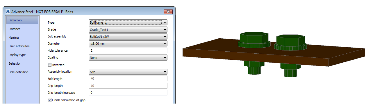

(Update defaults) button in the Tools tab
Tools panel to refresh the database to include your new settings.
You can now use your new bolt in the 3D model as needed:
