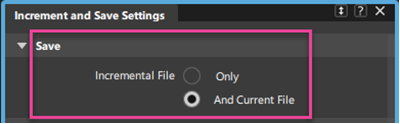

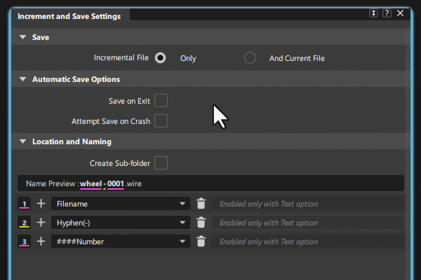

A new Incremental File option lets you save only an incremental file or save both an incremental file and your current working file. When you select Add Current File, an incremental file is saved according to the Location and Naming options, while your current file retains its original name. This is useful when you want to save incremental files without changing the name of the currently loaded file.
We've made the following additional UI updates to Increment and Save:
For more information, see Increment and Save.
