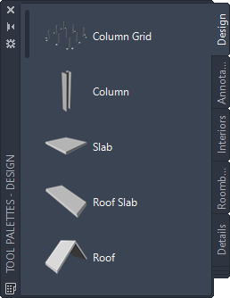

Tool palette containing slab and roof slab tools
