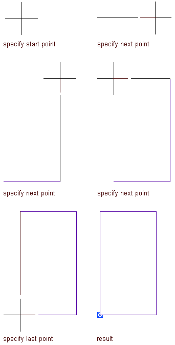

You add the slab or roof slab by specifying points to define its perimeter as follows:
- The first point determines the insertion point of the slab or roof slab and the start of the baseline. This point also locates the default pivot point of the slab or roof slab.
- The second point determines the endpoint of the baseline.
- Subsequent points establish the vertices of the perimeter.

Specify the start point of the slab or roof slab.
- Specify a second point to define the first edge (baseline) of the slab.
- Specify further points to finish defining the perimeter:

- Press Enter.
Drawing a slab
