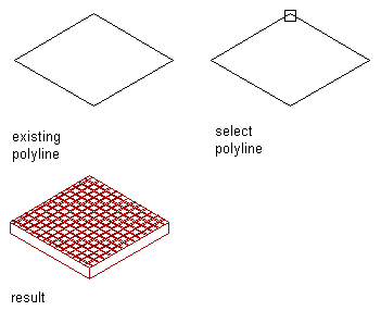

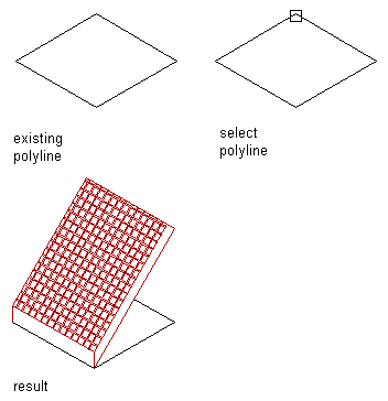

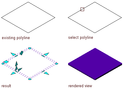

Linework and Walls (or Linework, Walls and Roof, in the case of roof slab tools). If you enter d (Direct), the polyline vertices become the vertices of the slab or roof slab perimeter. Any slope value specified in the tool properties is ignored.
Converting a polyline to a slab using the direct mode
Converting a polyline to a roof slab using direct mode
Converting a polyline to a roof slab using direct mode and adding a slope angle

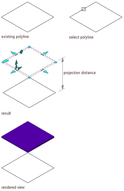

If you enter p (Projected), you are prompted for the base height of the slab or roof slab. The X,Y coordinates of the first polyline vertex are projected to a Z value of the base height. This establishes the insertion point.
Converting a polyline to a slab using the projected mode
