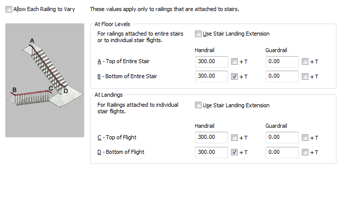

| use values in this dialog box to specify extensions at floor levels. |
clear Use Stair Landing Extension under At Floor Levels. |
| specify the length of the handrail and guardrail at the top of an entire stair |
under At Floor Levels, enter values for Handrail and Guardrail. Select + T next to the value to add the tread length to the extension value. |
| specify the length of the handrail and guardrail at the bottom of an entire stair |
| use values in this dialog box to specify extensions at landings. |
clear Use Stair Landing Extension under At Landings. |
| specify the length of the handrail and guardrail at the top of a flight |
under At Landings, enter values for Handrail and Guardrail. Select + T next to the value to add the tread length to the extension value. |
| specify the length of the handrail and guardrail at the bottom of a flight |
