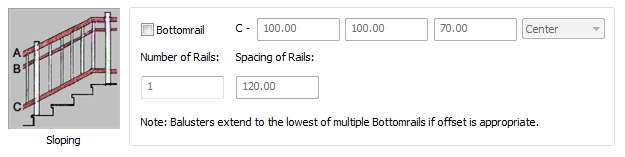

Use this procedure to change the following settings for bottom rails in a railing style:
| If you want to… | Then… |
| specify bottom rail properties, such as horizontal height, sloping height, and number of rails, when you add or modify railings | select Allow Each Railing to Vary. |
| require that all railings of this style use the bottom rail settings of the style | clear Allow Each Railing to Vary. |
| specify the height of the lowest rail when it is horizontal | enter a value for Horizontal. |
| specify the height of the lowest rail when it is on a stair flight | enter a value for Sloping. |
| designate more than one bottom rail | enter a value for Number of Rails. When you designate multiple bottom rails, you can enter a value for Spacing of Rails. |
