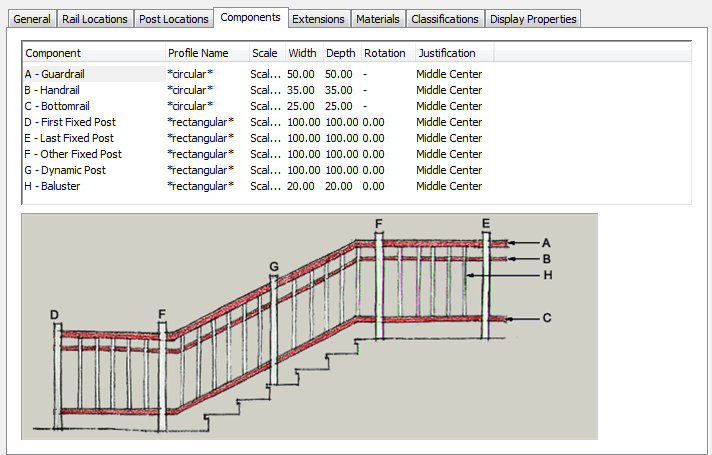

Use this procedure to specify the shape of the railing components, and the width, depth, and rotation of each component for each railing style.
You can use profiles to create railing components with custom shapes. The custom profile replaces a component on the Components tab of the railing style in the Style Manager.
The default profiles are circular and rectangular. Any profiles in the current drawing are also displayed.
Depth is not available for the default circular profile.
Rotation is not available for rail components, or when the default circular profile is used for posts.
