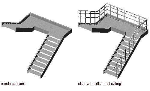

Use this procedure to create a railing that is attached to a stair and that has the settings that you specify.
Creating a railing attached to a stair
