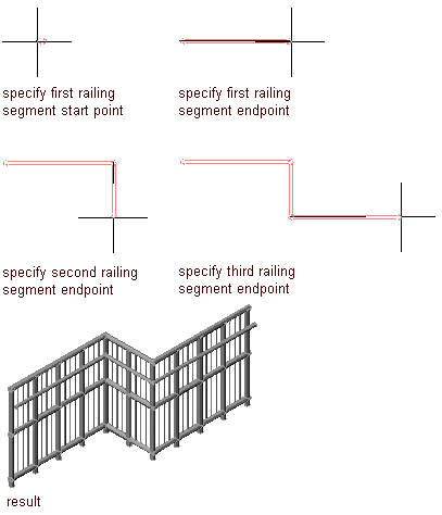

Use this procedure to create a freestanding railing in the drawing.
Creating a freestanding railing
