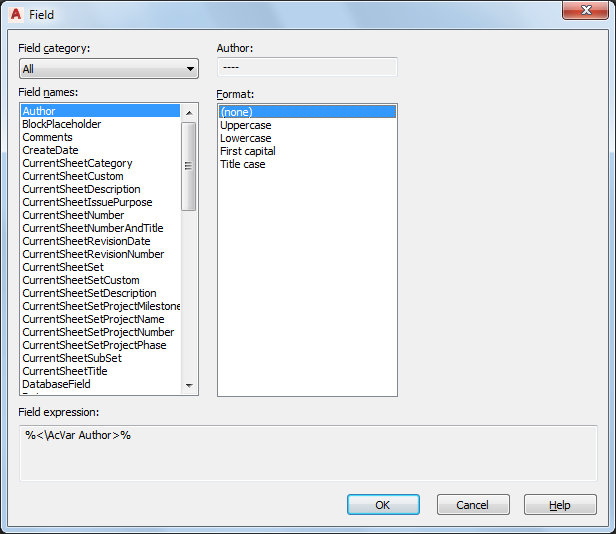

You can create field anywhere in a drawing. When a field is inserted directly, and not within another element, it is created as a multiline text element.
For example, if you want to insert a Plot Date field, you need to specify the date format.
