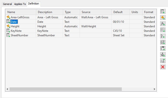

Use this procedure to insert a field in a property set definition.

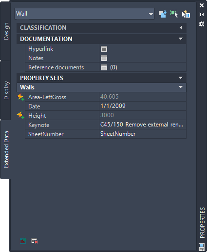

When you insert a field in a property set definition, the field will appear in the properties of any object or object style that has the property set attached.
Wall properties with keynote, date, and sheet number fields
| If you want to insert a … | Then… |
| date/time, document, hyperlink, object, system variable, Diesel expression, or plot field | see “Use Fields in Text” in AutoCAD help. |
| project field | see To Select a Project Field. |
| sheet set field | see To Select a Sheet Set Field. |
| keynote field | see To Select a Keynote Field. |
| database field | see To Select a Database Field. |
