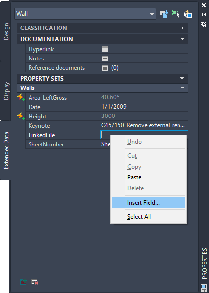

Use this procedure to insert a field placeholder in the properties of an individual object.
You can add a field to the properties of an individual object by creating a manual property as a placeholder for the field, to be filled when necessary. This would be useful if you want to add information that is different for each object and needs to be updatable.
Creating the placeholder
Inserting a field in the placeholder

In this example, you would likely insert a hyperlink to another file. selecting Linked for Field category and then selecting a file as the hyperlink.
