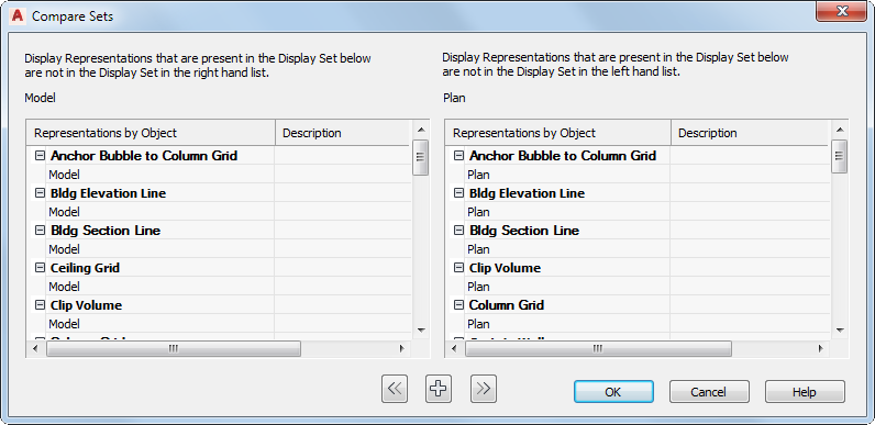

Use this procedure to view the differences in display representation assignments between two display sets.
The Compare Sets dialog box displays two lists. Each list contains display representations that are assigned to that particular display set, but are not assigned to the display set in the adjacent column.
Comparing display sets to view different display representation assignments
You can use the Compare Sets dialog box to assign one or more display representations to either display set.
. | If you want to … | Then … |
| assign a display representation on the left side to the display set on the right side | select the display representation name under the display set on the left side, and click |
| assign a display representation on the right side to the display set on the left side | select the display representation name under the display set on the right side, and click |
| assign all display representations to the other display set so both sets have identical assignments | Click |
