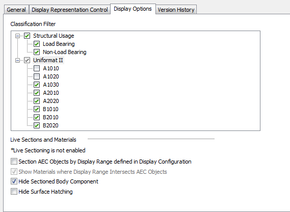

The classification filter lists all classifications in the current drawing. All classifications are selected by default.
For example, to hide all doors and walls classified as A1010 and A1020, clear the check boxes for A1010 and A1020 under Uniformat II.

To redisplay objects in a classification that were hidden, select the classification.
