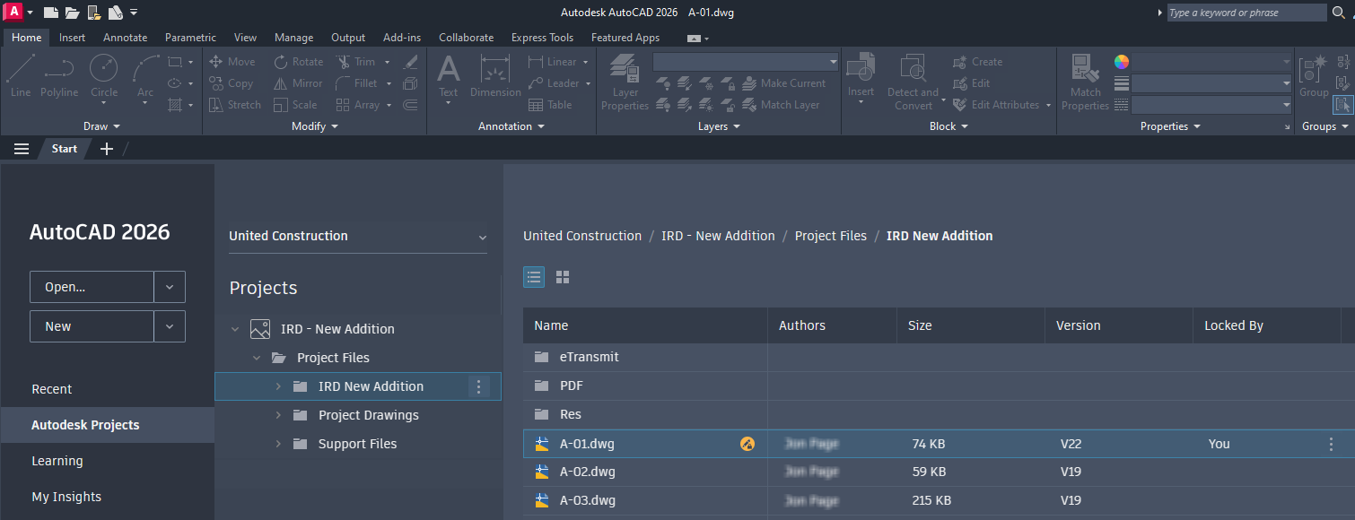

-  Once you have an initial project selected in Desktop Connector, in AutoCAD, on the Start page, click Autodesk Projects.
- On the Autodesk Projects tab, expand the project for which you want to set up Connected Support Files.
- Browse to and open a drawing within the project.

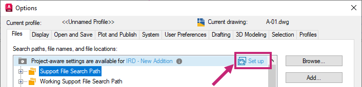

- With the drawing file open, right-click the drawing area and choose Options.

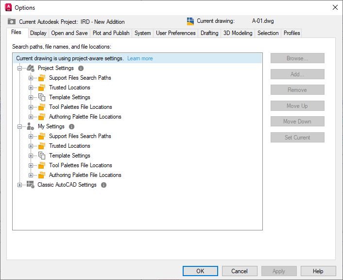

- In the Options dialog box, Files tab, click Set Up along the top of the Search Paths, File Names, and File Locations list of settings.
Note: If you don't see the Set Up option, the project might have previously been configured. This can be verified by the appearance of the text "Current drawing is using project-aware settings."

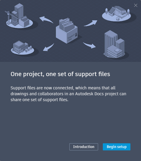

- In the One Project, One Set of Support Files dialog box, click Begin Setup.
Click Introduction if you want additional information on the Connected Support Files feature.
