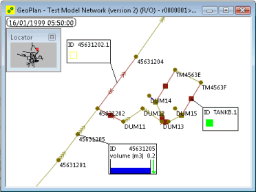

Visual feedback about the operating state of some network objects is displayed on Standard Labels.
For network objects with relevant controls, a colour coded symbol will be displayed on the label. The colour codes for the symbols follow the general rules:
Visual feedback is also available for some parameters; for example, level in a manhole. If these parameters are selected for display on a label a small graphic will be displayed. The graphic is updated during replay of the simulation to give feedback on the state of the network object. Parameters for which visual feedback will be displayed will have the text (Activates graphic) next to the their name on the Custom Label Settings Dialog - Content page.
The following table provides details about the visual feedback available on labels:

Manhole and Storage Node |
Visual feedback is displayed for the Volume (volume) and Level (depnod) Node parameters. A varying height bar representing the Volume/level at the manhole/storage node is displayed. An arrow shows if the volume/level at the node is currently increasing or decreasing. |

Visual feedback is displayed for the Regulator State (STATE_Q) Pump Parameter (Variable Speed Pump only). A varying height bar representing the current discharge of the Variable Speed Pump is displayed. An arrow shows whether the discharge is increasing or decreasing. |
Graphical Labels example
