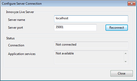

Configure Server Connection Dialog
This dialog is used to configure a server connection with ICMLive Operator Client (the client).
Configure a server connection Dialog
It is displayed when you select the Server connection option from the File menu or click Server connection button (Server connection) on the Overview toolbar.
The current connection status is given by the colour of Server connection button (Server connection). See the Overview toolbar fo details of the connection status colour.
The following parameters of this dialog are to be configured:
Server name – Name of machine where the server is located.
Server port – Port on the machine where the server is located and the server is listening to for client connections .
Reconnect – Once a server name and a server port have been specified, clicking Reconnect updates the client-server connection configuration to the new settings.
The Status section displays read-only status information relating to the current client-server connection:
Connection – Displays the status of the connection, which may be one of the following:
Applications services – Displays the status of the application services and can be one of the following:
