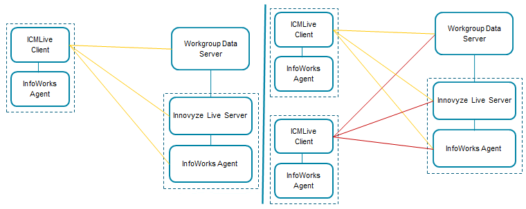

Server connectivity
The
Innovyze Live Server can run without a client connected and will in this case require connectivity to a database (usually a Workgroup Server) and to an InfoWorks Job Agent (usually running on the same machine). Please see the
InfoWorks ICM help for more information about Workgroup Servers and Job Agents.
However the most common configurations are likely to be a single-or multiple-client connectivity. In both cases, the clients have got their own
InfoWorks Agent, usually running on the same machine, and they also connects to the
InfoWorks Agent that the server is connected to.
Single- and multiple-client connectivity
