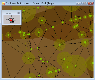

The outlines of the underlying triangles that make up a TIN ground model can be displayed on the GeoPlan Window.
TIN Triangles Displayed on the GeoPlan
Note: The underlying triangles are only displayed if the TIN ground levels are displayed as a theme.Only display TIN triangles when needed. With triangles displayed the performance of the GeoPlan Window will be affected.
