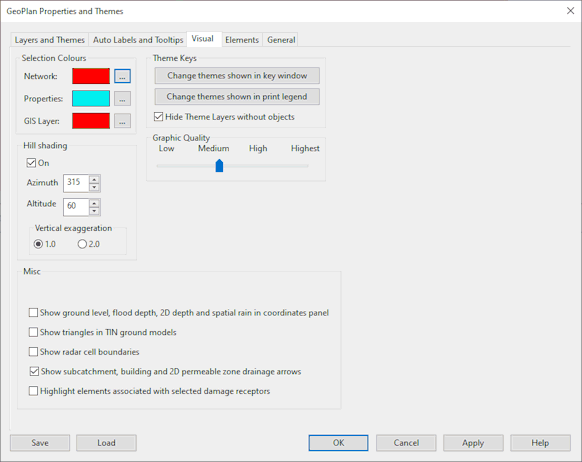

This page of the GeoPlan Properties dialog controls visual effects on the GeoPlan Window such as selection colour, hill shading settings, theme keys and theme graphic quality.
This section is used to change the selection colour of objects displayed in the GeoPlan Window:
) and choose the new selection colour from the
Windows Colour Picker dialog.
The selection colours that can be changed are:
tool), the object will be momentarily highlighted using this colour.
You can use hill shading to emphasise the contours of a ground model displayed on the GeoPlan Window. Hill shading simulates a light source (the sun) which you can point towards your model from any:
You can also exaggerate the vertical scale to make contours stand out more clearly.
The best effects from hill shading need to be found by trial and error, and will vary depending on the ground model.
The options in the miscellaneous section are as follows:
The format in the panel is X, Y, G, F, D, R, where:
X, Y correspond to the GeoPlan X,Y coordinates at the current point
G is the ground model level at the current point
F is the flood depth at the current point
D is the 2D depth at the current point
R is the spatial rain at the current point
Check Show subcatchment, building and 2D permeable zone drainage arrows to turn on the display of arrows on the GeoPlan View showing the drainage nodes for subcatchments, buildings and permeable zones. The arrows are drawn from the centroids of the subcatchment, building and permeable zone to the drainage nodes. The colours used for the lines are the same as the colours used to draw the subcatchment, buildings and the permeable zone polygons. If the node is at the centroid of the subcatchment, building or permeable zone, no line will be visible.
This section allows users to fine tune theme visibility on the GeoPlan, Thematic Key Window and on printouts.
Hide Theme Layers without objects: when checked, indicates that if no object of a particular type exists in the network, the legend for it (of the type symbol - object type) will be hidden in the Thematic Key and printed legend.
Both the Change themes shown in key window and the Change themes shown in print legend buttons allow you to specify en masse which of the layer themes are to be respectively shown in the Thematic Key window and the printed legend.
This slider governs the switching between two different types of Microsoft Graphics Device Interface, GDI and GDI+ (see Options - General Page for other GDI+ settings) which are responsible for representing graphical objects and transmitting them to output devices such as monitors and printers. Compared to GDI, which draws faster, GDI+ takes longer to draw but it has the advantage of supporting anti-aliasing, transparency, gradient shading and modern graphics file formats.
The switch is based on the number of objects to be drawn and the slider adjusts the threshold. Middle values for the slider should be preferred as these represent a trade-off between speed and graphic quality.
Note that in GDI mode, lines or symbols with very low visibility will not be drawn. For large networks, when displaying themes that use a range of visibility settings, set the Graphic Quality to a higher setting to view transparency effects (may affect drawing speed).
