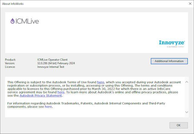

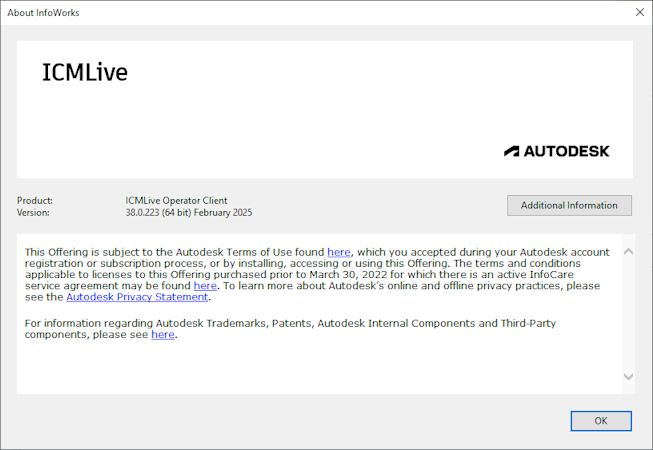

The About InfoWorks box displays usage agreement information about your current ICMLive Operator Client installation, as well as the version build number of the installed software and the licence name, which is read from the server.
The About Box is displayed by selecting About InfoWorks from the Help menu.
An example of the About InfoWorks box when using ICMLive Operator Client with an Innovyze licence:
An example of the About InfoWorks box when using Autodesk ICMLive Operator Client:
