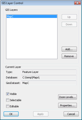

GIS Layer Control ArcEngine dialog
ArcGIS Engine GIS Layer Control dialog
GIS Layer Control ArcObjects dialog
ArcGIS Desktop GIS Layer Control dialog
ArcGIS Map (Tech Preview) GIS Layer Control Dialog
GIS Layer Control Map Xtreme dialog
MapXtreme GIS Layer Control dialog
Use this dialog to choose how layers are displayed on the GeoPlan Window when using ESRI ArcGIS Engine, ArcGIS Desktop or ArcGIS Maps, or Precisely MapXtreme .NET, as the GIS component.
All layers can be moved up or down, or forward or backwards, in the display order, added and removed, or temporarily hidden without removal. The layer can also be hidden automatically when the zoom level moves outside a certain range.
The GIS Layers box lists the layers that are currently loaded on the GeoPlan. The layers are added to the view in the order shown, with the layer at the top of the list being displayed above all other layers.
The following buttons change the layers that are displayed:
Up
Moves the selected layer higher up the list.
Down
Moves the selected layer lower down the list.
Bring forward Applies when using ArcGIS Maps as map control.
Moves the selected layer forward in the display order.
Send backwards Applies when using ArcGIS Maps as map control.
Moves the selected layer backwards in the display order.
Add WMS
Applies when using MapXtreme as map control.
Displays the Add WMS Layer dialog.
In the Add WMS Layer dialog, enter a WMS Server URL and click OK.
The WMS layer is added to the list of GIS layers.
Select the WMS layer and click the Properties button to view and edit the display properties for the layer in the Web Map Service Properties dialog.
Add layer Applies when using ArcGIS Maps as map control.
When Layer Type is set to:
  • Web Map
    Displays the Add Web Map Layer dialog so you can choose the applicable online map layer. Selecting a layer, then clicking OK, adds the web map layer name to the GIS Layers box.
  • Shapefile or Raster image
    Displays a Windows Open dialog so you can browse for the applicable file. Selecting a file, then clicking Open, adds itsname to the GIS Layers box.
  • File Geodatabase
    Displays the Add File Geodatabase Layer dialog so you can browse for the applicable feature layer. Selecting a Geodatabase folder, selecting a layer and clicking Add Feature Layer, adds the layer name to the GIS Layers box.
Layer Type Applies when using ArcGIS Maps as map control.
The type of layer that can be added. See Add layer (above) for details.
Add
Adds a new layer.
Remove
Removes a layer from the display (the data is unaffected).
