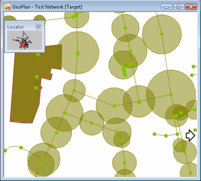

Automatic panning
You can switch on an option that allows you to automatically pan the GeoPlan Window. To switch this option on or off:
  1. Choose Options from the Tools menu. This displays the Options dialog.
  2. Select the GeoPlan page.
  3. Check or un-check the Enable Auto-Panning when at the edge of the GeoPlan box.
With the option enabled:
GeoPlan with Automatic Panning Cursor visible on the right
Note: This option may be quite slow if you have a large amount of data to redraw on the GeoPlan Window. You may want to use one of the other methods if you have a large network visible, or if you are using additional layers containing complex data.
