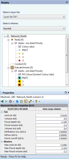

ICMLive Operator Client has several windows containing important or additional information that can be docked to any side of the ICMLive Operator Client main window that does not already contain a toolbar or menu bar, so the information is always visible.
The dockable windows are:
These windows can also be undocked so that they float within or outside the application window (which can be very useful for those working on multiple screens). Because of their special properties, you can float these windows outside the bounds of the ICMLive Operator Client Main Window.
Dockable windows are modeless (you can work in any other part of the ICMLive Operator Client interface when you open a dockable window).

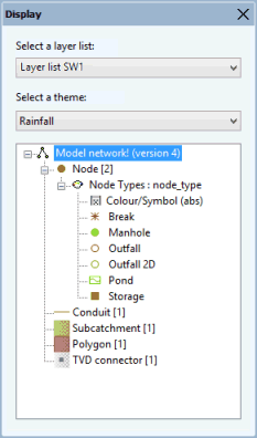

As mentioned above, a dockable window can be docked or floating:
Example of dockable Window - docked position
Example of dockable Window - floating position

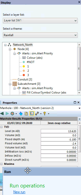

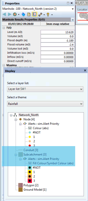

You can reposition a docking window by dragging its title bar to the desired location. If the window is already docked, starting to drag will cause it to float. If you then drag it close to the side of the application window, or over another docked window, a blue highlight will show the location at which the window would be docked.
Blue highlight showing the location where the Theme Window will be docked when the mouse is released.
If this is the desired location, simply release the mouse button and the window will dock. If not, continue dragging until the highlight changes to the desired location.

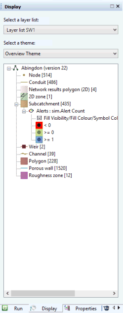

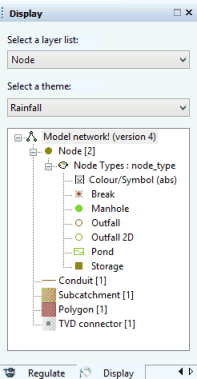

When there is more than one window docked to the same side, those windows can be laid out in one of two ways: Stacked or Tabbed.
Stacked Layout
Tabbed Layout
