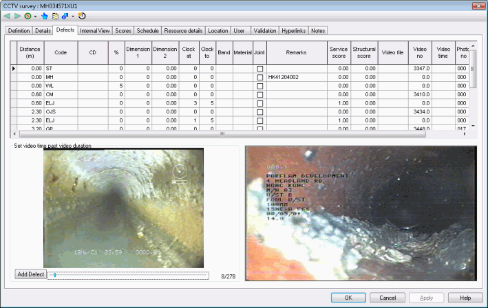

CCTV Survey Defect Data on the property sheet
You can import CCTV data from data files (see the table above) and also enter and edit CCTV Survey data using the CCTV Survey Grid Window of the Survey Grid. CCTV Surveys are shown overlaid on associated pipe objects in the GeoPlan Window and integrated with the pipe data in the Grid Window. This gives a clear visual representation of the fraction of network that has been surveyed.
The Defects Page on the CCTV Survey Property Sheet allows detailed defect information to be viewed, with integrated digital photo and video support. You can also view the location of CCTV defects on the GeoPlan Window and Long Section View.
