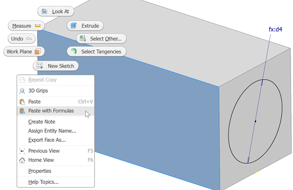

Copy and Paste a Sketch
You can copy and paste a sketch from one face to another and from one component to another. Depending on the paste command you choose, user parameters will be copied and pasted.
Select and right-click the source sketch, or simply right-click it, then click Copy.
Right-click the target face in the same or other component, and click:
- Paste to paste the sketch geometry and any related constraints.
- Paste with formulas to paste sketch geometry, related constraints, and user-defined parameters. Pasted user parameters are not duplicated.
