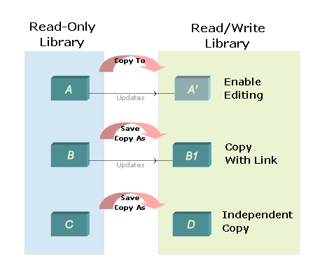

To edit a part (feature) family that is contained in a read-only library, copy the family to a read/write library. Two commands are available in Content Center Editor to copy content to a read/write library:
The following scheme displays the overview of copying families into read/write libraries:
The link has no use until the parent family is edited, and you synchronize the library including the copied family by using the Update Tool. If the link between parent and copied family is active, Update Tool propagates changes from the parent family to the copied (child) family. In case the same data are edited in the parent and in the copied family, all your edits are preserved in the read/write library.
A family with a link behaves the same as independent family with the following exceptions:
Copy To families always create a link to their parents. Save Copy As families can be created with or without a link.
Suppress a link to defer synchronization of a copied family. A copied family with a suppressed link is skipped during synchronization in the Update Tool. Use the Unsuppress command to activate a suppressed link. The library with the corresponding copied family is then marked as Synchronization Needed, and you can synchronize the family.
Use the Break Link command to remove a link to parent for a Save Copy As family. The family becomes independent. You cannot restore a broken link.
