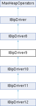

3ds Max C++ API Reference
Interface into the biped driver controller for Max 9. More...
#include <C:/adskgit/3dsmax/3dsmax/3dswin/src/maxsdk/include/CS/Biped9Api.h>
This contains functions supporting new biped features in Max 9, in particularly new functionality for setting large number of keys onto a biped at once, e.g. by loadin an XAF file.
