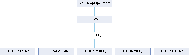

Inheritance diagram for ITCBKey:

Detailed Description
See also
Class IKey.
Description:
This is the base class for Tension Continuity and Bias keys.
Data Members:
float tens;
The tension setting. Values are in the range -1.0 to 1.0, where 0.0 is the default.
float cont;
The continuity setting. Values are in the range -1.0 to 1.0, where 0.0 is the default.
float bias;
The bias setting. Values are in the range -1.0 to 1.0, where 0.0 is the default.
float easeIn;
The ease in value. Values are in the range 0.0 to 50.0, where25.0 is the default.
float easeOut;
The ease out value. Values are in the range 0.0 to 50.0, where 25.0 is the default.
